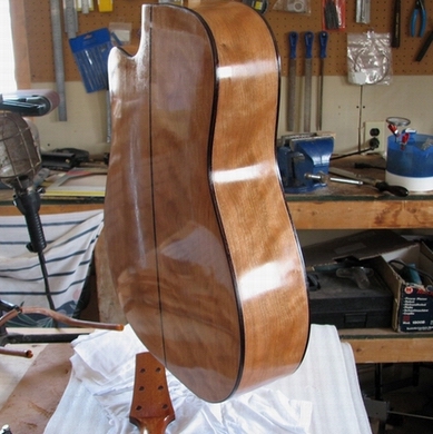

I just love the stuff. Extremely forgiving. You can have a few 'sessions' on there, sand back to the wood (if you spot a ROS swirl mark ) and have the baby back to spit shine condition in ten minutes flat.
   I was a bit aprehensive before trying FP. Reading on the difficulties and time required to apply a good finish. But after just a few 'sessions' I'm sold big time. The secret is not to load with too much shellac/alcohol. Once you get the mix right, you're laughing.
   Here's a picture after my third 'session'. I had let it gaz out so that's why you see some of the oil permeating to the surface.
